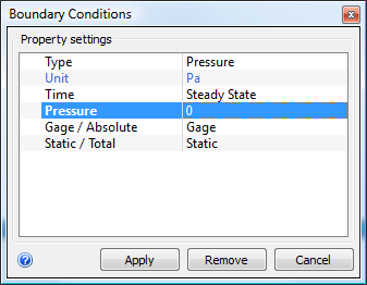

Open the Boundary Conditions quick edit dialog in ONE of the following ways:
Type = Pressure
Unit = Pa; Pressure = 0
Click Apply.
