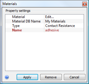

Open the Materials quick edit dialog in ONE of the following ways:
Material DB Name = My Materials
On the Material quick edit dialog, Type = Contact Resistance
Name = adhesive
Click Apply.
