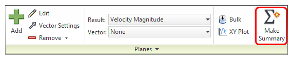

To make the plane a Summary Plane, click Make Summary in the Planes context panel:

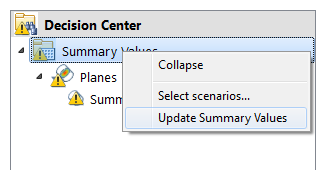

In the Decision Center, right click on Summary Values, and click Update summary values.
