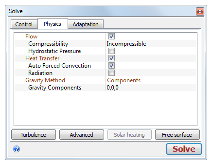

Click Solve from the Setup tab:
Click the Physics tab.
Flow = On
Heat Transfer = On
Auto Forced Convection = On
Click the Control tab.
Iterations to run = 100
Click Solve to start the analysis.
