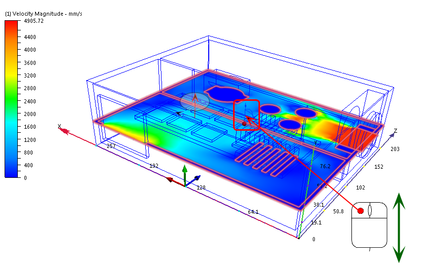

In this step, we examine the velocity results using a cutting plane and an iso surface.
Cut planes show results on a slice through the model. Use them to gain a comprehensive understanding of the flow. Use vectors to show the velocity direction and magnitude throughout the device.
Iso surfaces show a single value of a result quantity. Use them to identify where the result quantity is very low or very high relative to the rest of the model.
Click Planes from the Results tab:
To create a Plane, click Add on the Planes context panel:
To orient the plane, left click on it, and click this icon from the context toolbar:
Y
To move the plane, drag the triad axis normal to the plane.

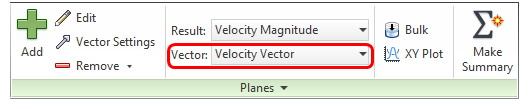

To display vectors, select Velocity Vector from the Vector menu on the Planes context panel:
To adjust the vector spacing:
To display vectors with varying lengths (scaled with Velocity):
