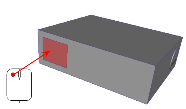

Outlet Pressure Boundary Condition
Select the outlet.
Open the Boundary Conditions quick edit dialog in ONE of the following ways:
- Click Edit from the context toolbar:
- Click Edit from the Boundary Conditions context panel:
Type = Pressure
Unit = Pa; Pressure = 0
Click Apply.
