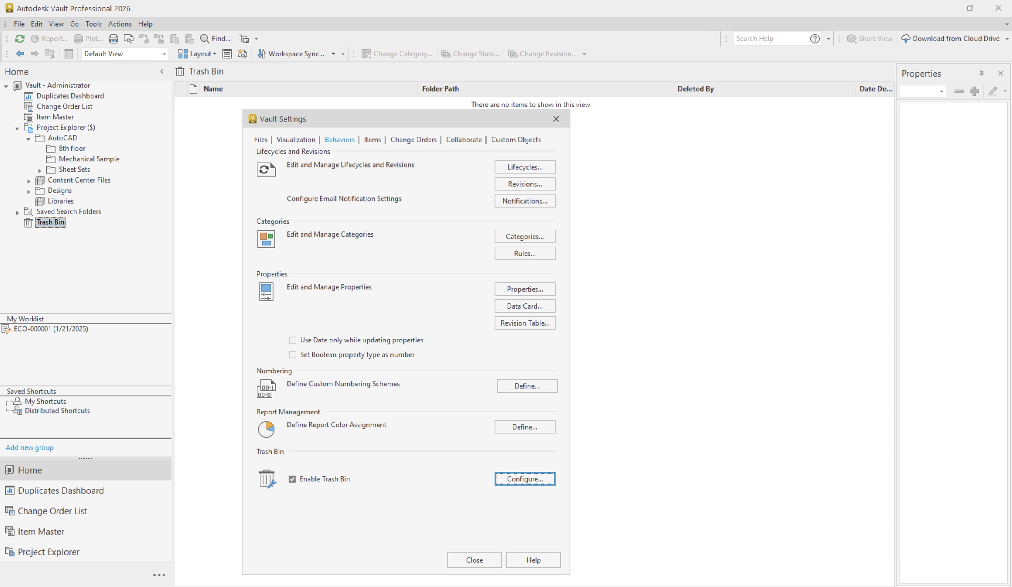

As an administrator, you can enable or disable the Trash Bin functionality in the Vault Settings > Behavior tab. Once you disable the Trash Bin functionality, the Delete workflow will return to permanently deleting the file or folder.

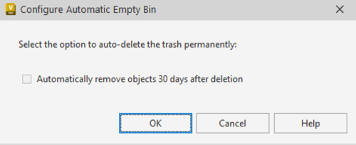

As an administrator, you can choose to automatically remove objects from the bin 30 days after deletion or manually empty the bin at any time. You can perform the following actions within the Trash Bin workflow:
