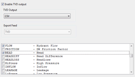

Used to set up export options for time-varying data. Show image
| Option | Application | Description |
Enable TVD output |
Enable the export of TVD data by checking this box. |
TVD Output |
Enabled when TVD output is enabled |
Select the type of output to which you want to export the time-varying data (CSV or Database) |
Export Feed |
Enabled for export to database only |
Select the live data export feed to export. This dropdown list is automatically populated with live data export feeds that have an export type of Time-varying results. (Export type is assigned in the Live Data Export View page of the live data object). |
Attribute list |
This list contains the most common TVD results fields for all network objects. Select the attributes to be exported by checking the adjacent boxes. Note: You are still allowed to select attributes even if TVD output is disabled. In this case, selection will be ignored and no TVD results will be exported. CSV export: TVD export files are placed in a subdirectory of the output folder (specified in the General page of the Export Style dialog) called TIMESTEP. File names are of the type \$Prefix_$Type_$Result.CSV where $Prefix is defined in the export style dialog General page, $Type is the table name such as wn_node and $Result is the type of result, for example Pressure. |
