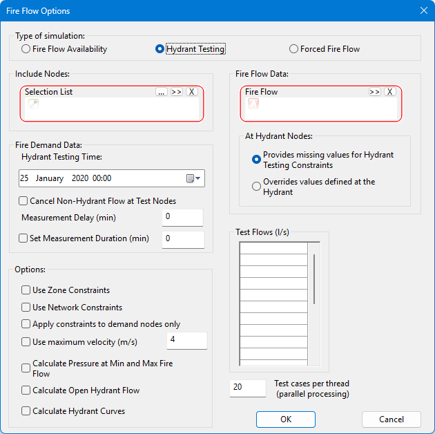

Fire Flow Options dialog - Hydrant Testing view
This dialog view lets you set up a hydrant testing simulation to test a selection of nodes in turn against a number of fire flow test parameters. A hydrant testing report is produced containing details of flows and pressures at each test node and whether the node passed or failed. A node will pass if the minimum fire flow required can be supplied without breaching any of the pressure constraints applied.
Hydrant testing will be performed only on selected regular nodes and hydrant nodes.
The fire flow data object is used to specify fire flow test parameters for regular nodes. Fire flow test parameters for hydrant nodes may be specified at individual hydrant nodes or provided from the fire flow data object.
The hydrant testing simulation is performed as a series of steady state analyses. Each node is considered independently, as if no other hydrant in the system is open.
If a Measurement Duration time is specified, the hydrant test is run from the test time and results are evaluated from the delay time (if set) until the end of the combined test-time, delay time, and duration. When a Measurement Duration is specified, all the hydrant tests are performed with a fully open hydrant.
Note: The Hydrant Testing Fire Flow run type can only use fully open hydrants for non-zero Measurement Durations as it's not possible to do availability tests at every time-step and produce compatible results for the grid display; there will be completely different values for the available flow and minimum residual pressure at every time-step during the test.
This dialog view is opened by selecting Hydrant Testing on the Fire Flow Options dialog.
Parameter Description
Include Nodes
Selection List
You must add a selection list of nodes to be tested. Only regular and hydrant type nodes will be tested. Other objects in the selection will be ignored.
For regular Hydrant Testing, the selection list is mandatory. However, if using GMR Hydrant Testing, the selection list should be removed for reasons of efficiency. When the selection list is not removed, the application will report a warning message asking you to remove it. The selection list is replaced by the Analysis Tab on the GMR Configuration Object.
When a Fire Flow run is validated and saved without a selection list, an error message will be displayed.
Fire Flow Data
Fire Flow
Select the fire flow data object to be used during analysis.
The data in the fire flow data object will be applied at all regular test nodes.
At Hydrant Nodes
There are two options for the use of the fire flow data object:
  • Provides missing values for Hydrant Testing Constraints - Data from the fire flow data object item will be used for fire flow constraints data fields that have no values defined at the hydrant node to be tested.
  • Overrides values defined at the Hydrant - Data from the fire flow data object will override values defined at the hydrant node to be tested.
Fire Demand Data
Hydrant Testing Time
Defines the point at which the hydrant test begins during the simulation period. This must be between simulation start and end time.
Note: Setting the time here sets the same value on the Forced Fire Flow view.
Cancel Non-Hydrant Flow at Test Nodes
Check this box to cancel any local demand and exceptional flow applied to the test node at hydrant testing time (see above).
Note: Checking this box will override the Keep Local Demand check box in the fire flow data object.
Measurement Delay
You can use this to set a delay between the start of the hydrant test and the point from which results will be calculated i.e. the point when measurement of the hydrant test's effects on the network occurs/begins.
This is useful for hydrant tests on nodes that are downstream of control objects which use control types that react to changes in conditions on the following simulation timestep, namely PRVs and objects controlled via UPC. In this situation, it is recommended to set Measurement Delay at 1 min so that the network can properly react to the increased flows from the hydrant test, whilst having minimal impact on the overall network mass balance.
This can also be used when understanding the impact of an extended (more than a single timestep) fire flow event on the network is required, as the network simulates the outflow from the hydrant test over the entire delay period. For example, a network that feeds an area undergoing a fire flow event via a small reservoir/tank may have that storage depleted within a short time window, resulting in the minimum flow and/or residual pressure requirements not being met after that point; setting a measurement delay covering the required/average fire flow event period enables this to be tested.
Note: Setting the delay time here sets the same value on the Forced Fire Flow view.
Set Measurement Duration
You can set a measurement duration time by checking the box and then entering a number of minutes into the accompanying input box.
If a measurement duration time is specified, the hydrant test is run from the test time and results are evaluated from the measurement delay time (if set) until the end of the combined test-time, delay time, and duration. All the hydrant tests are performed with a fully open hydrant.
Options
Use Zone Constraints
Check this box to enforce zone constraints during analysis.
Use Network Constraints
Check this box to enforce network constraints during analysis.
Apply constraints to demand nodes only
Check this box to enforce zone constraints and network constraints at nodes with assigned demand only.
If this box is unchecked, all basic nodes will be tested against constraints. Reservoir, Well and Fixed Head nodes will be excluded from the check.
Use maximum velocity
Hydrant Testing and Forced Fire Flow can operate with maximum velocity as a constraint. This is a check box in the options for the simulation to enable this constraint.
  • There is a global maximum for this constraining velocity, in the options dialog.
  • Also, each link’s control allows a setting of maximum velocity. This individual setting will be used if the options check box is set, and the individual setting overrides the global maximum for that link.
The hydrant report shows, for each hydrant tested, the name of a “maximum velocity link”, and that link’s maximum velocity and its constraint velocity.
  • If no links experience a velocity constraint, then the link with the greatest velocity is displayed. Also, if that link has its own defined constraint, then that link’s particular constraint is displayed. Otherwise the global constraint from the simulation options is displayed.
If one or more links experience a constraint on their velocity, then one of those links is displayed along with its corresponding maximum velocity and constraint velocity. (The constraint should be viewed as a ceiling velocity which is approached but not exceeded. The link that is displayed is the one that most nearly approaches its constraint.)
Calculate Pressure at Min and Max Fire Flow
Check this box to calculate pressures at the minimum and maximum fire flow.
Calculate Open Hydrant Flow
Check this box to calculate the maximum flow at the hydrant when the hydrant is fully open.
Calculate Hydrant Curves
Check this box to calculate a hydrant curve of Residual Pressure against flow.
Test Flows (grid)
Available only if the Calculate Hydrant Curves box is checked.
You can enter up to twenty flows in the grid.
Not available if the Set Test Duration box is checked.
Test cases per thread (parallel processing)
You can use this to distribute the test cases when using parallel processing.
Tip: For GMR fire flow hydrant tests, by setting a value of 0, an algorithm is used to calculate the optimum value to use for the simulation.
