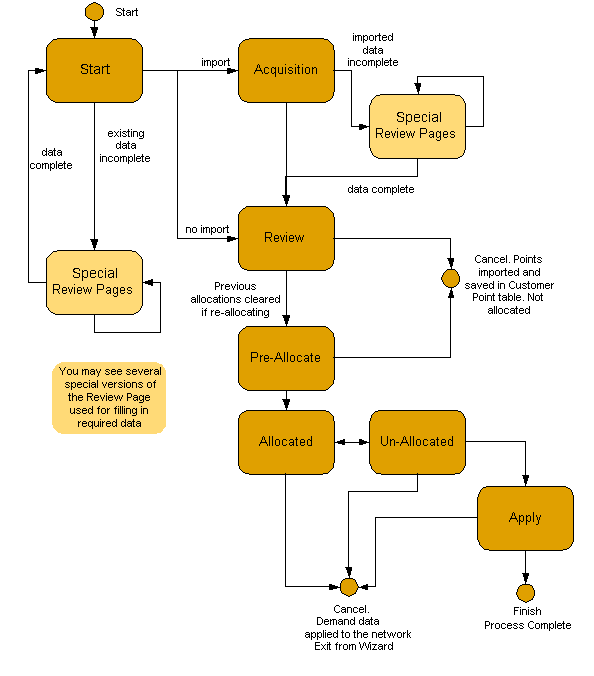

Using the wizard
The wizard has a number of pages:
- Start Demand Allocation page - Re-allocate data and select data to import if appropriate.
- Data Acquisition Control page - Used for import only. Map the fields from the import data onto
InfoWorks database fields.
- Review Data page - Review and/or adjust the data available for allocation. You can also limit the data points used for allocation. Special versions of the Review page are used to fill in missing data.
- Potential Allocation Pipes page - You can limit the objects in the network that are used for the allocation process.
- Allocate to Network page - Set rules and options for the allocation process, and then allocate the data to network objects. The allocation can be undone, adjusted, and redone as often as required.
- View Unallocated page - Review the currently unallocated data. You can return to the Allocate page and change the rules if required.
- Apply page - Finish page of the wizard. Displays additional information.
The schematic below shows the steps through the Static Demand Allocation wizard. Click a box to go to the relevant page.
