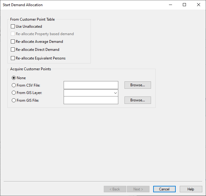

The Start page is the first page displayed when the Static Demand Allocation Wizard is opened.
There are several options available on the Start Page:
Validation of the allocation of previously allocated Customer Points is carried out to ensure that customer point demand has been assigned correctly to nodes. Errors are displayed in the window in the lower half of the page.
Note:
The allocation fields of child customer points will be flagged as default (#D) when allocation is carried out via the Wizard. If the child customer point was previously allocated to a pipe, this allocation will be lost. The child will be allocated to the same pipe as the parent customer point. (A warning will be displayed in the errors window if a child customer point is allocated to a pipe at the time of opening the wizard.)
Existing Data Points
If there are existing customer points in the Customer Points Grid then the options in the From Customer Point Table box are available:
Note:
However, remember that if additional points are imported, and the Overwrite or Merge options are used (Acquisition Page), the parameters of existing allocated points may be changed.
Multiple options may be chosen. If none of the options are selected, allocation will only affect any newly imported data points.
Importing Customer Points
Customer point data may be imported, in addition to, or instead of, the above options. Import options are displayed in the Acquire Customer Points box. Data may only be imported from one source at a time. The choices are:
Ensure that the correct import option is selected using the radio buttons on the left. If the Browse buttons or the drop-down lists are used as described above, the correct option should be selected automatically.
Finally
If new points are to be imported, clicking Next displays the Acquisition Page. If only existing customer points are to be used, clicking Next displays the Review Page.
If there is any required data missing from existing customer points, special versions of the Review Page will be displayed, where the data can be entered. You will then be returned to the Start Page.
