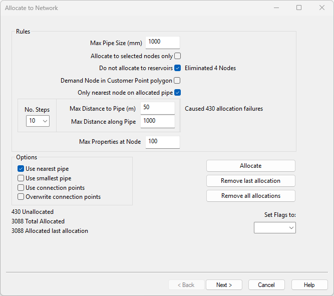

Rules
The table below describes the demand allocation rules when carrying out allocation using Customer Point coordinates.
If the Use connection point option is selected (see Options section below), demand allocation will be carried out using the coordinates of the connection points of customer points where available.
The rules do not apply to child customer points, (with the exception of the Max Properties at Node rule). If the parent customer point satisfies the rules, the parent and children will be allocated, regardless of whether the children satisfy the rules. See Parent and Child Customer Points for more information.
Note that a value of zero for the Max Pipe Size, Max Distance or Max Properties rules, is taken to mean that the rule should not be used in the allocation process.
Rule Description
Max Pipe Size
Pipes with a larger diameter than the specified diameter will be excluded from the allocation process.
Allocate to selected nodes only
Check this option to limit allocation to nodes that are currently selected on the GeoPlan.
Do not allocate to reservoirs
Check this option to prevent allocation of demand to reservoir nodes.
Demand Node in Customer Point polygon
Check this option to limit allocation to nodes that fall within the same set of polygons as the Customer Point to be allocated. If a customer point is located within more than one polygon, the allocation node must fall within all of the same polygons as the customer point.
For example: customer point C is located within Polygon 1 and Polygon 2. If allocating to the nearest node, the customer point would be allocated to Node A. As Node A is only within Polygon 1, the customer point will instead be allocated to Node B.
Only nearest node on allocated pipe
Allocate to the node (on allocated pipe) that the customer point is closest to only. If the number of properties on nearest node has been exceeded, the customer point will not be allocated.
No. Steps
Number of iterations to be used when carrying out allocation.
See Distance Steps section below for more details.
Max Distance to Pipe
If the distance to the nearest point on a pipe from the customer point exceeds the specified distance, the customer point will not be allocated.
Max Distance along Pipe
If the distance along the pipe from the nearest point on the pipe from the customer point is greater than the distance specified, the customer point will not be allocated.
If the number of properties already attached to a node exceeds the maximum specified, the node will be discounted from the allocation process.
Note:
A parent customer point and its children are allocated as a group. If the inclusion of children results in the Max Properties at Node rule being exceeded, none of the customer points making up the group will be allocated. (This may result in allocation failures despite the number of properties already attached to a node being less than the maximum specified.)
Options
Option Description
Use nearest pipe
Check this option for demand to be allocated to the nearest pipe to the customer point that satisfies the above rules.
If neither the nearest pipe option or the smallest pipe option is selected, InfoWorks will allocate demand to any pipe that satisfies the above rules.
(If the Use connection points option is checked, demand will be allocated to the nearest pipe to the connection point of the customer point.)
Use smallest pipe
Check this option for demand to be allocated to the pipe with the smallest diameter that satisfies the above rules.
Check this option to carry out allocation using connection point coordinates (defined in the Connection Point X and Connection Point Y data fields of the customer point) in preference to customer point coordinates.
  • If connection point coordinates have not been defined for a customer point, the customer point coordinates will be used when carrying out allocation.
  • If the connection point coordinate data fields are flagged as default (#D), the connection point coordinates will be calculated as the nearest location (to the customer point) on the pipe to which the customer point is allocated.
Overwrite connection points
Check this option to overwrite customers points that have been assigned manually to a different connection point. When selected, the affected customer points will use the default (#D) connection point.
When this option is selected, the Use connection points box becomes unavailable.

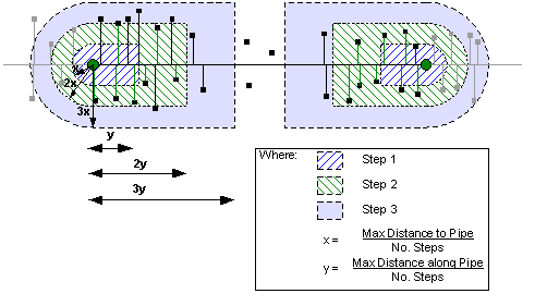

Distance Steps
In order to carry out an accurate demand allocation, an iterative process should be used, increasing the maximum distance along a pipe and the maximum distance to the pipe after each allocation.
The example below shows a demand allocation carried out in five distance steps, increasing the distance along the pipe and distance to the pipe by 100 each step.
Demand Allocation using Distance Steps
This method of allocation using the Demand Allocation Wizard, is more accurate than carrying out the allocation in a single step.

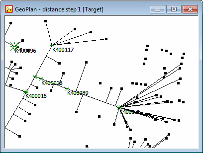

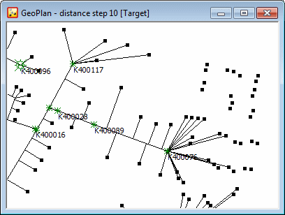

For example, if the customer points that could potentially be allocated to a node exceed the Maximum Properties at Node specified by the user in the Demand Allocation Wizard, allocation of these customer points to the node is effectively random. Customer points further from the pipe may be allocated, while customer points closer to the pipe may not. This is demonstrated in the example below, where demand allocation has been carried out on the same network, using the same allocation parameters, but with a different number of distance steps.
Demand Allocation carried out using one distance step
Demand Allocation carried out using ten distance steps
The distance steps drop down list on the Allocate Page of the Demand Allocation Wizard, provides an "automatic" option for carrying out demand allocation by distance steps.
InfoWorks WS Pro will carry out demand allocation using the number of steps selected from the dropdown list. The options are: 1,2,3,4,5 and 10.
The Max Distance to Pipe and Max Distance along Pipe rules, specified by the user, represent the limits to be used at the last distance step. These limits are divided by the number of distance steps to calculate the amount to increment the Max Distance to Pipe and Max Distance along Pipe parameters at each allocation step.
Buttons
Button Description
Allocate
Attempts to allocate the demand using the above Rules and Options. When the allocation is complete, the Rules box will contain additional information about how the rules that have been applied have affected the allocation process.
Remove last allocation
Clears allocations carried out from the last click of the Allocate button
Remove all allocations
Removes all allocations for the current set of points. This is the list that was displayed on the Review Page. Allocations from previous uses of the wizard will not be displayed unless the Reallocate options on the Start Page have been selected.
Note: These options are not available when the dialog is accessed from the Task Sequence editor.
Flags
Select a flag from the dropdown list if required. This will flag the Allocated Pipe ID field of successfully allocated points. This can be viewed in the Customer Points Grid or the Customer Point Property Sheet of individual customer points.
