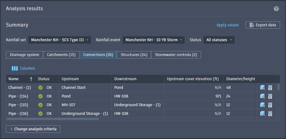

When your system analysis is complete, the result are reported at the system level, and as object categories: Inflows, Pipes, Structures and Stormwater.
To Adjust How You View the Data
Use the filters at the top of the Analysis Results to isolate analysis data.
Tip: Click Apply values in the upper right-hand corner of the Analysis results to apply Energy Grade Line (EGL) and Hydraulic Grade Line (HGL) values to pipes and structures in the drainage system.
To Review and Modify your Drainage System
Much like the initial system check for errors and warnings, you can step through individual objects in your drainage system and adjust for potential problematic issues. Each category (displayed as tabs above the data table) has its own unique analysis data and status warnings. Step through any requiring attention and use the following tools for correction.
