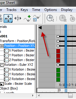

Toggling the Controller Window
Available in the Key window of the Track View dialog (in both Curve Editor and Dope Sheet modes) is a control for toggling the Controller window. The control takes the form of a black triangle that points to the left when the Controller window is visible and to the right when it is hidden, as shown in the preceding illustration. To toggle the Controller window, click the triangle. By using this feature to hide the Controller window, you can maximize the available space for editing keys.
Tip: This toggle is also available on the Customize User Interface dialog as the action Show/Hide Controller Window in Group: Main UI > Category: Track View.
