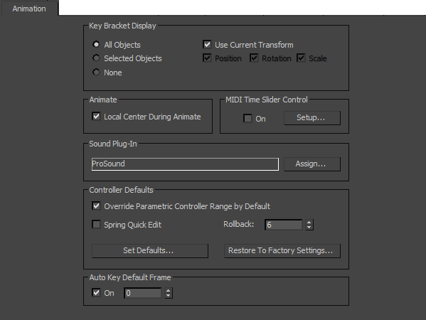

Controlling Key Bracket Display
Animation panel of the Preference Settings dialog
You can control the display of key brackets using options in the Preference Settings dialog > Animation panel.
