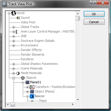

To assign a controller to a variable:
  1. Highlight the variable name in the Scalars or Vectors list.
  2. Click Assign Controller or Assign Controller \ Node if a Vector variable is highlighted. (If the current variable type is Vector, you can assign a scene node to the highlighted variable. The node's world transform position is taken at the current time plus the variable's Tick Offset. See To assign a Node to a Vector variable, below)
    3ds Max opens the Track View Pick subdialog, showing the track hierarchy. The dialog display is similar to the Track View hierarchy.
  3. Highlight the track for the variable to use, and then click OK.
  1. Highlight the variable name in the Vectors list.
  2. Click Assign Controller \ Node. 3ds Max opens the Track View Pick subdialog, showing the track hierarchy. The dialog display is similar to the Track View hierarchy.
  3. Highlight the Node for the variable to use, and then click OK.

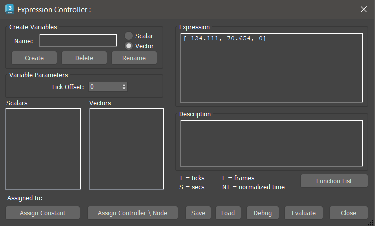

Interface
Expression Controller dialog: Create Variable set to Vector
Tip: You can resize the dialog by dragging an edge or a corner.
Create Variables group
Name
The variable name.
Scalar/Vector
Choose the type of variable to create. If you choose Vector, the Assign Controller button changes to Assign Controller \ Node. (See interface image, above)
Create
Creates the variable and adds it to the appropriate list.
You must enter a name and specify a type before clicking Create.
Delete
Deletes the highlighted variable in the Scalars or Vectors list.
Rename
Renames the highlighted variable in the Scalars or Vectors list.
First highlight the variable in the list; this places the name in the Name field. Edit the name in the Name field, and then click Rename; the new name replaces the previous one in the list.
Variable Parameters group
Tick Offset
Contains an offset value. A tick is 1/4800 of a second. If a variable has a non-zero tick offset, that value is added to the current time.

Expression window
Enter the expression to evaluate. The expression must be a valid mathematical expression. The result is either a three-value vector for a vector expression (position, scale, or point3) or a scalar value for a float expression.
Description window
Enter optional text do document the expression. For example, you can describe user-defined variables.
