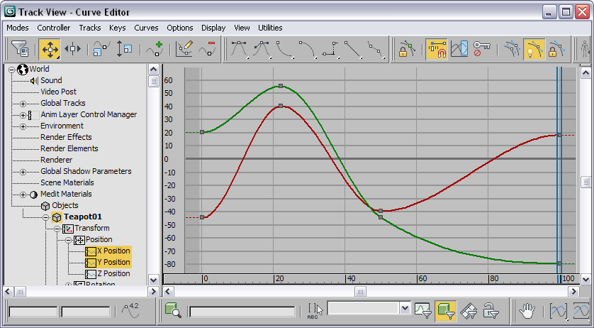

  1. Start with an animated object, and open the Curve Editor.
    In this example, the teapot position was animated on the X axis between extents of about –45 to 40, and on the Y axis between extents of about –80 and 54.

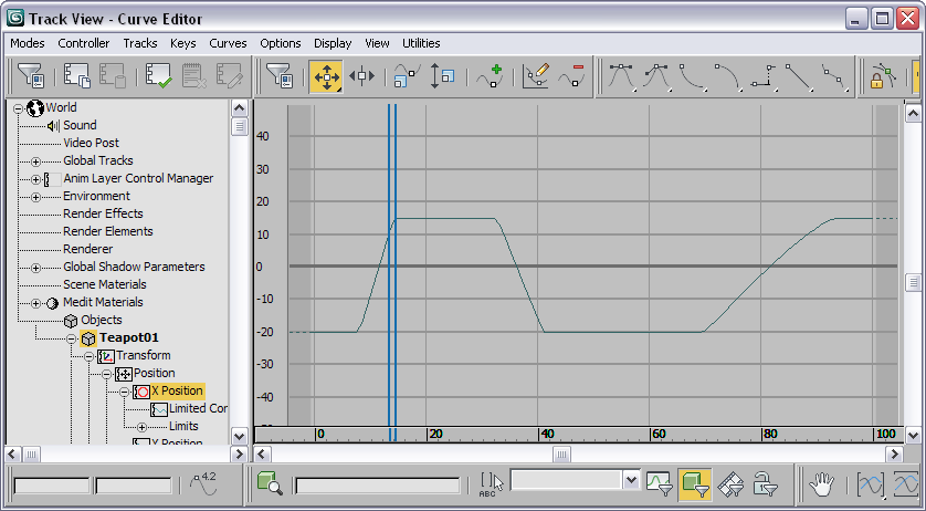

  5. Scrub the animation until the X-axis position is where you want to set a limit. In this example, the position is about -20, where we'll set a lower limit.
  6. Highlight the X Position track, and then right-click and from the right-click menu choose Limit Controller > Set Lower Limit.
    The graph curve is now clipped below the lower limit. When you scrub the animation, the object doesn't move beyond that position.
  7. Again scrub the animation, stop where you want to set the upper limit, right-click the X Position track, and choose Limit Controller > Set Upper Limit.
    In this example, we've set it at about 13. The graph curve is now clipped above the upper limit and below the lower limit. The resulting motion is likewise constrained.
  8. Scrub the animation.
    The motion on the X axis is limited at both extremes; wherever the object originally moved beyond the limits, it now behaves as though it's hitting a wall.
  9. Again compare the two tracks.
    The Limit Controller (X Position) track clearly shows the upper and lower clipping, while the Limited Controller track shows the original motion.

  12. Highlight the Y Position track and note how its curve differs from that of the X Position track.
  13. Highlight the X Position track, and then right-click and choose Limit Controller > Copy Limit Only.
  14. Highlight the Y Position track, and then right-click and choose Limit Controller > Paste Limit Only. When the Paste dialog opens, click OK to confirm the paste as a copy.
    Now the Y Position track is also limited, using the same extents as the X Position track, but retaining its original underlying motion. To verify this, compare the Y Position track with its child Limited Controller track.

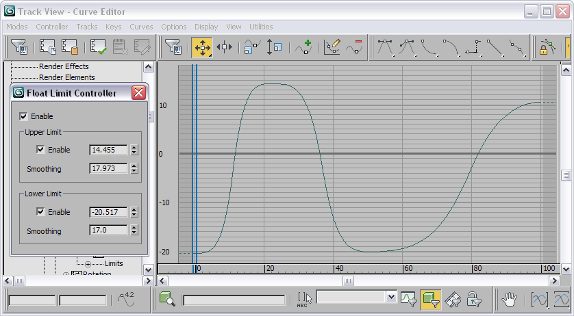

    Finally, we'll cover the Smoothing Buffer settings. By default, sharp corners are created wherever a curve is limited, causing abrupt changes in motion. You can smooth off these corners with the Smoothing Buffer parameters, resulting in more natural-looking motion.
  17. Highlight the X Position track, and then right-click it and choose Properties.
    This reopens the Float Limit Controller dialog.
  18. Use the Upper Limit group > Smoothing Buffer spinner to increase the Smoothing Buffer value as far as it can go.
    As you increase the value, the corners of the upper limit on the graph become smoother.
    Note that there's an upper limit to this value; in this case, it's 34.973. This limit is determined by the values of the other three settings on the dialog.
  19. Try increasing the Lower Limit group > Smoothing Buffer. It's not possible with the upper smoothing value at its maximum.
  20. Decrease the upper smoothing value, and then increase the lower smoothing value.
    Now you get smoothing at both the upper and lower limits.

[Upper Limit value]
The highest value permitted by the Limit controller. Any values above this value in the original controller are clipped; that is, they're set to this value, unless smoothing is in effect. Default=1000.0.
You can animate this value via keyframing and other standard methods, and manipulate this animation in Track View via the Upper Limit track in the controller's Limits branch.
Smoothing Buffer
Specifies a smoothing value, so that clipped values at the beginning and end of a clipped range gradually increase and decrease instead of leveling off abruptly.
The maximum total smoothing is determined by the Upper and Lower Limit values. (Upper Limit > Smoothing Buffer value) + (Lower Limit > Smoothing Buffer value) cannot exceed this total. For the smoothest possible results at the upper and lower extents of the clipping, set either Smoothing Buffer value to the maximum amount, and then back it off to half that value and set the other Smoothing Buffer to the same amount.
You can animate the Smoothing Buffer value via keyframing and other standard methods, and manipulate this animation in Track View via the Upper Smoothing track in the controller's Limits branch.
