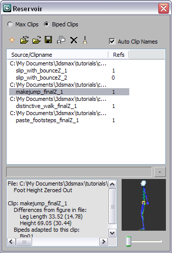

The Reservoir comprises four parts:

Source / Clipname list
The Source / Clipname List displays all the clips you have in the Motion Mixer Reservoir. Four pieces of important information can be gathered from this list:
As you add clips to a track, from the Tracks menu or by right-clicking a track, they are automatically added to the Reservoir. If the clip is a new adaptation, the name of the clip is assigned an incremental suffix, such as 1 or 2.
The Refs (Reference) column tells you how many times a clip instance has been used in the Motion Mixer, or if it has not been used at all. If an instance shows a Refs value of 1 or more, it means the instance has been used that many times. If an instance shows a Refs value of zero, it means the clip was once used by one or more bipeds, but is not currently used on any tracks.
If a clip has been added to the reservoir, but has never been placed in the Motion Mixer, only the source path will be listed and no Refs value is displayed.
[Clip Status window]
The Clip Status window appears at the lower left of the Reservoir and gives you information about how a particular clip has been used. You can get file information, such as the source location of the BIP or XAF file. Clip information is also displayed, like the name of the clip reference as it appears in the Motion Mixer. Information about the biped structure is also listed along with the bipeds to which the clip has been adapted.
[Motion Preview]
The Motion Preview at the lower right side of the Reservoir shows a thumbnail of the selected clip. Moving the slider across the bottom gives you an idea of what the motion looks like before you add it to a track.
Note: In order for a clip to show in the Motion Preview, it must be a BIP file that has been saved for this version of 3ds Max. If you choose a BIP file that is from an older version of 3ds Max, you will see a warning that the file is obsolete and should be resaved. Until the BIP file is resaved, it will not display in the Motion Preview.
Note: The Motion Preview is available only when you choose the Biped Clips option.
