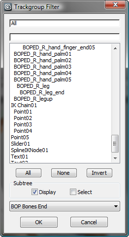

Filter...
Opens the Trackgroup Filter dialog where you can customize the object body parts that are included in a trackgroup mix. This command is only available when a single trackgroup is selected. For more information, see Trackgroup Filter Dialog (Non-Biped Object), Trackgroup Filter Dialog (Biped Object), or Filtering Mixer Tracks.
The Trackgroup Filter dialog for biped object mixes.
The Trackgroup Filter dialog for non-biped object mixes.
