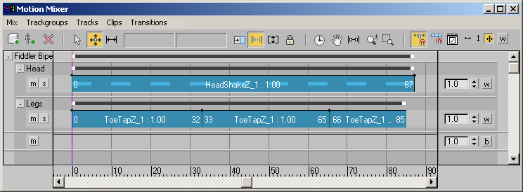

  4. On the Motion Mixer toolbar, click image (Editable Time Warps).
    A series of evenly spaced dashes appears on the clip. The lengths of the dashes indicate the relative speed of the clip at various points. Right now, all dashes are evenly spaced to indicate the clip is playing at its original speed from beginning to end.

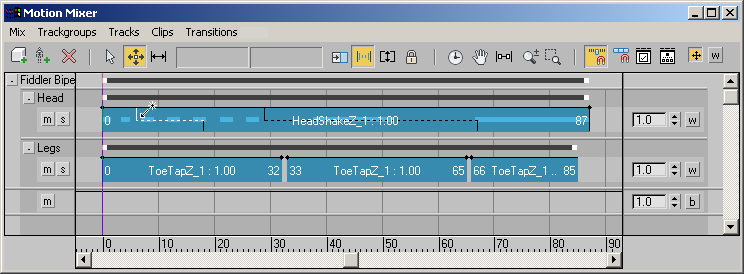

  5. Move the cursor over the clip's horizontal center line until an arrow cursor appears.
  6. At the approximate original time, click the clip to set a time warp bar.
    A time warp bar actually consists of two parts, a top and a bottom.
  7. Click the top half the bar. The top half turns white to indicate it is selected.
  8. Drag the top half of the bar to the left or right to set it to the warped time noted in step 3 of the previous procedure. This will cause the motion at the original time to occur at the warped time.
    Tip: As you drag the top bar, watch the Frame value at the top of the Motion Mixer window to see the top bar's new frame number.
    The lengths of the dashed lines change to indicate the new timing. Where lines are shorter, the motion will play faster. Where lines are longer, the motion will slow down.

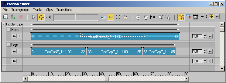

  9. Select and move the bottom bar to change the original time.
    Either bar can be moved to change the effect of the time warp. The length of separation between the two bars sets the degree of time-warping that will occur. When both bars are aligned, no warping occurs.
