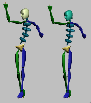

When you use different motions on the upper and lower parts of the biped, you can create a situation where the balance in the two clips do not match one another. For example, if the arms are waving wildly in the motion used for the upper body, the hip motion should compensate to some degree to keep the biped in balance. A straight mix of this arm motion with another hip/leg motion will most likely not match up in terms of balance.
Bipeds with same set of upper and lower body motions. Biped on the left has balance compensation, biped on the right does not.

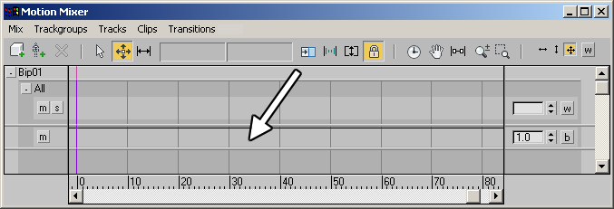

In the Mixer, you can control the degree of automatic balance compensation using the balance track. One balance track is automatically created for each biped as it is added to the Mixer.
Balance track
Tip:
image If the balance track for a biped is not displayed, click Preferences on the Motion Mixer toolbar, and turn on Balance Curves on the Mixer Preferences dialog.

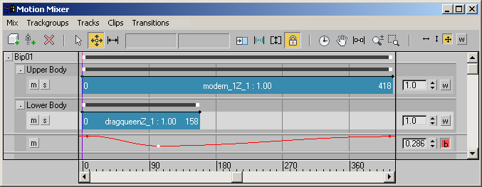

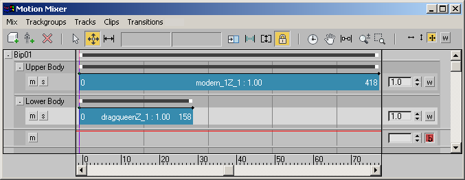

  6. Click image (Balance Weight Mode). This button is at the far right of the balance track.
    The weight curve becomes visible at the top of the balance track.
    Tip: If you can't see the weight curve, click Preferences to display the Mixer Preferences dialog, and turn on Weight Curves.
  7. Add nodes to the weight curve, and adjust the nodes. For information on how to add nodes and edit weight curves, see Adjusting Track Weight.
    When the weight is set to 0.0, the Mixer will not adjust the spine and pelvis motion to compensate for differences in the upper and lower body motion. Values between 0.0 and 1.0 will adjust the balance to some degree.

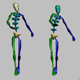

  4. To adjust the degree to which spine rotation from the lower body motion is propagated on the upper body, change the Propagation parameter. Higher values rotate the spine links to better follow the COM and pelvis motion.
    Bipeds with same upper and lower body motion. Biped on left has Propagation set to 0.0, biped on right with Propagation at 1.0.
