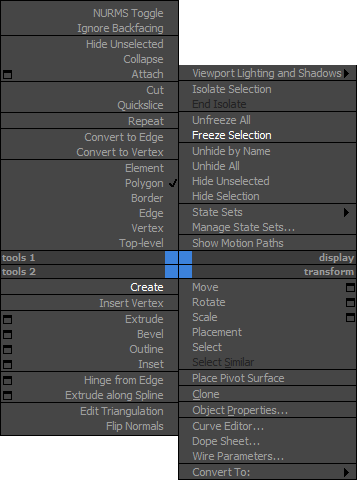

Default quad menu for an editable poly object at the Polygon sub-object level
Transform quadrant
These options are available from the Transform quadrant:
Move
Lets you move objects. This is the same as clicking Select and Move on the main toolbar.
You can open the Transform Type-In by clicking the icon to the right of Move on this menu.
Rotate
Lets you rotate objects. This is the same as clicking Select and Rotate on the main toolbar.
You can open the Transform Type-In by clicking the icon to the right of Rotate on this menu.
Scale
Lets you scale objects. This is the same as clicking Select and Scale on the main toolbar. If one of the other Select and Scale flyout buttons is active on the main toolbar, that tool becomes active when you click Scale on the quad menu.
You can open the Transform Type-In by clicking the icon to the right of Scale on this menu.
Placement
Lets you move and rotate objects with respect to other objects in the scene. This is the same as clicking Select and Place on the main toolbar.
Select
Lets you select objects.
Select Similar
Automatically selects objects similar to the current selection.
Place Pivot Surface
Lets you place a working pivot by clicking any surface including the grid.
Clone
Lets you clone objects. This is the same as choosing Clone from the Edit menu.
Object Properties
Opens the Object Properties dialog for a selected object. This command is available only if an object is selected when you open the quad menu.
Curve Editor
Opens and displays the selected object at the top of the Track View Hierarchy. This command is visible only if an object is selected when you open the quad menu.
Dope Sheet
Opens and displays the Dope Sheet.
Wire Parameters
Starts a wire parameter from the selected object. This command is available only if an object is selected when you open the quad menu.
Convert To
This submenu lets you convert the selected object to an editable mesh, editable spline, editable patch, editable poly, or a NURBS surface. This command is available only if an object is selected when you open the quad menu.
Display quadrant
These options are available from the Display quadrant:
Viewport Lighting and Shadows
Isolate Selection
Lets you edit your selection while hiding the rest of the scene.
Tip: You can use this iteratively to delve into a large selection set.
End Isolate
Exits Isolate mode.
Unfreeze All
Unfreezes all frozen objects.
Freeze Selection
Freezes the selected objects. Frozen objects are visible in the viewports, but cannot be manipulated.
Unhide by Name
Displays a version of the Select from Scene dialog, letting you choose objects from a list to unhide.
Note: You cannot unhide an object on a hidden layer. If you select and object on a hidden layer, a dialog will prompt you to unhide the layer first.
Unhide All
Displays all hidden objects.
Hide Unselected
Hides all visible objects that are not selected. Hidden objects still exist in the scene, but do not appear in the viewports or in rendered images.
Hide Selection
Hides the selected objects.
State Sets
Opens a submenu for working with state sets:
Manage State Sets
Opens the State Sets dialog.
Show Motion Paths
Shows the motion path for the selected object in the viewport.
