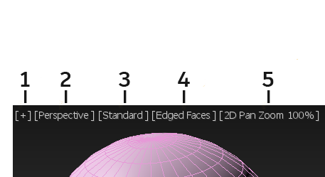

Depending on the display driver selected, each viewport contains a series of up to five menus in the top left hand corner that control viewport display.
The menus are:
  1. General
  2. Point-of-View (POV)
  3. Shading
  4. Per-View Preference (Nitrous only)
  5. 2D Pan Zoom (displayed only in 2D Pan Zoom mode)
Click or right-click a menu to view its specific options.
