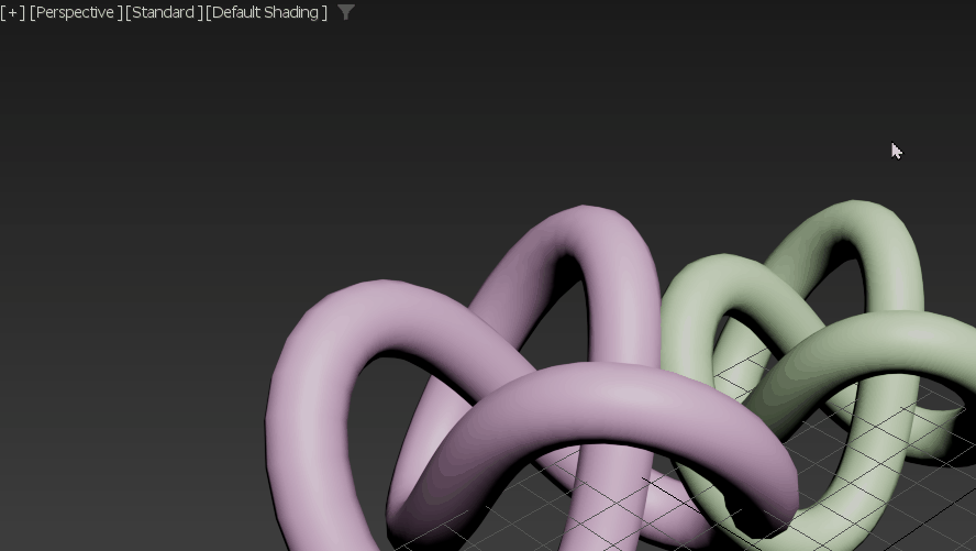

The 3ds Max Search bar lets you locate specific tools, functions, and settings without having to navigate through multiple menus and options. As you type, the dialog auto completes with a list of similarly named actions. Choose the action from this list to apply the action and close the dialog.
To open the search dialog:
X to open the Search bar at the cursor location.To search for an action:
Type in the first few letters of the action.
The dialog displays a list of actions whose name matches the string. The Search prioritizes search results by actions that begin with the typed letters in the Starts With section, followed by any combination that contains the entered text string in the Starts with any word list.
In the example below, the entered string " tar " first shows words that begin with Tar, like Tar get, and followed by "Find Tar get".
Searching for the phrase "tar"

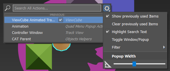

The Search settings
Click the
gear icon next to the Search field to expand the Search settings. #### Show previously used items
Check to show the history of last five used actions. This option is on by default.
Removes the list of last used actions.
Shows the entered search characters in a different color than the search results.
Switches from the pop up dialog to a window.
Lets you adjust the length of the Search pop up, which is better for searches with longer item names, for example Create Standard Camera from View.
