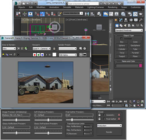

In addition to geometry, viewports can display other views such as Track View and Schematic View, which display the structure of the scene and the animation. Viewports can be extended to display other tools such as the MAXScript Listener and the Asset Browser. For interactive rendering, the viewport can display the ActiveShade window.

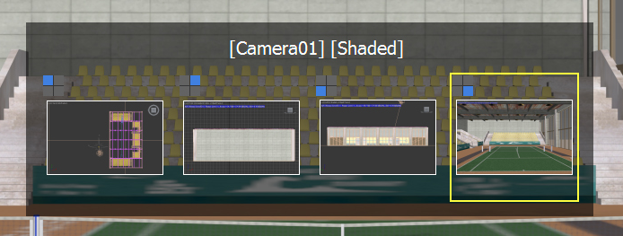

When viewports are not maximized, pressing image (the Windows logo button, sometimes labeled "Start") + Shift cycles the active viewport. When one viewport is maximized, pressing image + Shift displays the available viewports, and you can press image + Shift to cycle among them: When you release the keyboard buttons, the viewport you chose becomes the maximized viewport.
Overlay thumbnails for switching the maximized viewport
