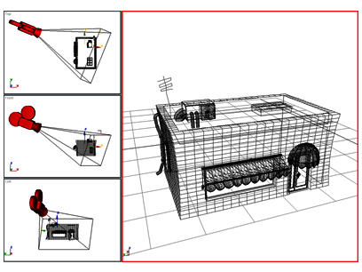

Using multiple viewports can help you visualize the scene. Here, the largest viewport shows the view from the camera depicted in the other viewports.
