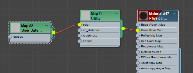

  1. In the Material Editor, add a Physical material to the active view and apply it to the Point Cloud object.
  2. Add an Arnold User Data node and an Arnold Utility node to the active view.
  3. Connect the User Data node output to the Utility color input.
  4. In the Attribute field of the User Data node, type colors.
  5. Connect the Utility node to the Physical material's Base Color Map input.
This gives the Point Cloud object a look similar to that obtained with the default material, with the added benefit of enabling the object to respond to scene lighting. Note, however, that any shadows incorporated in the original capture remain.

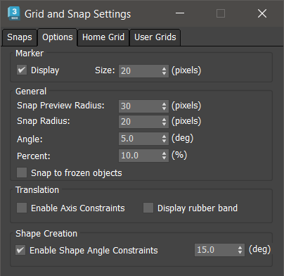

  4. On the main toolbar, click 3D Snap to turn on snapping, then right-click the same button to open the Grid And Snap Settings dialog.
    By default, the dialog opens to the Snaps panel with the Standard category active and the Grid Points option enabled.
  5. Turn off Grid Points, then click Standard and choose Point Cloud Objects from the drop-down list.
  6. In the Point Cloud Objects category, turn on the single option: Point Cloud Vertex. Close the dialog.

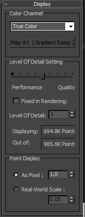

Display rollout
Color Channel
The method of coloring the Point Cloud data in the viewports and in rendered output. Choose one of the following from the drop-down list:
Level Of Detail Setting group
Performance/Quality slider
Controls the number of visible points in the cloud in the viewports. When Fixed In Rendering (see following) is off, this setting also affects the rendered output. To reduce the number of visible points and improve performance, move the slider toward the left (Performance) end of the scale. To increase the number of visible points, move the slider toward the right (Quality) end of the scale. For better-looking results at the potential cost of performance, use the right side of the scale.
The number of points currently visible and the total number of points in the object appear in the read-only fields at the bottom of the Level Of Detail Setting group: Displaying and Out Of, respectively.
Note: The available range of points depends on the viewpoint distance from the Point Cloud object. Typically a wider range is available at greater distances, and moving the viewpoint closer reduces the range at the both ends. So the number of visible points at the Performance setting is lower when the viewpoint is relatively distant from the object, and higher when closer to the object. The following illustration shows the results of using the extreme ends of the scale at different distances with a Point Cloud object containing about 444,000 points. image Point cloud object viewed from far away (top) and close up (bottom): 1: Performance (13,600 points visible) 2: Quality (444,000 points visible) 3: Performance (161,000 points visible) 4: Quality (384,800 points visible)
Fixed In Rendering
When on, the Level Of Detail setting (see following) determines the visible number of points at render time. In this case, the Performance/Quality slider (see preceding) has no effect on rendered output.
Level Of Detail
Determines the number of points in the object visible in rendered output when Fixed In Rendering (see preceding) is on. The higher the value, the more points in the object are rendered. Range=1 to 100. Default=1.
Point Display
Choose how points in the cloud are displayed:
The following illustration depicts a Point Cloud model at the lowest Level Of Detail setting (Performance) with three different As Pixel values. Note that the lower As Pixel values permit seeing "through" the closest surface to the underlying surfaces.
1: As Pixel = 0.5
2: As Pixel = 1.0
3: As Pixel = 4.0
Tip: One way to get good performance with a solid-looking object is to use a relatively large Point Display setting with a low Level Of Detail setting.
