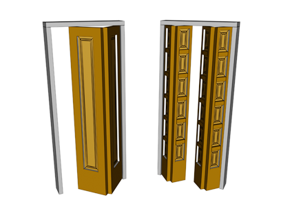

BiFold Door
The BiFold door is hinged in the middle as well as on the side. It has two door elements. You can also make the door a double door, with four door elements.
Single and double bifold doors
