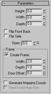

Parameters rollout
Flip Front Back
Changes which element is in front, compared to the default.
Flip Side
Changes the current sliding element to the stationary element, and vice versa.
