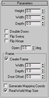

Parameters rollout
Height
Sets the overall height of the door unit.
Width
Sets the overall width of the door unit.
Depth
Sets the depth of the door unit.
Open
With Pivot doors, specifies in degrees the extent to which the door is open. With Sliding and BiFold doors, Open specifies the percent that the door is open.
Frame group
This group has controls for the door-jamb frame. Though part of the door object, the frame behaves as if it were part of the wall. It doesn't move when you open or close the door.
Create Frame
This is turned on as a default to display the frame. Turn this off to disable display of the frame.
Width
Sets the width of the frame parallel to the wall. Available only when Create Frame is on.
Depth
Sets the depth of the frame as it projects from the wall. Available only when Create Frame is on.
Door Offset
Sets the location of the door relative to the frame. At 0.0, the door is flush with one edge of the trim. Note that this can be a positive or negative value. Available only when Create Frame is on.
Generate Mapping Coords
Assigns mapping coordinates to the door.
Real-World Map Size
Controls the scaling method used for texture mapped materials that are applied to the object. The scaling values are controlled by the Use Real-World Scale settings found in the applied material's Coordinates rollout. Default=off.

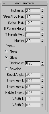

Leaf Parameters rollout
Provides controls that affect the door itself (as opposed to the door unit, which includes the frame). You can adjust the dimensions of the door, add panels, and adjust the dimensions and placement of those panels. The total number of panels for each door element is the number of horizontal divisions times the number of vertical divisions. Pivot doors have a single door element unless they are double doors. BiFold doors have two door elements, or four if they are double doors. Sliding doors have two door elements.
Thickness
Sets the thickness of the door.
Stiles/Top Rail
Sets the width of the panel framing on the top and sides. This setting is apparent only if the door is paneled.
Bottom Rail
Sets the width of the panel framing at the base of the door. This setting is apparent only if the door is paneled.
# Panels Horiz.
Sets the number of panel divisions along the horizontal axis.
# Panels Vert.
Sets the number of panel divisions along the vertical axis.
Muntin
Sets the width of the separations between the panels.
Panels group
Determines how panels are created in the door.
None
The door has no paneling.
Glass
Creates glass panels with no beveling.
Thickness
Sets the thickness of the glass panels.
Beveled
Choose this to have beveled panels.
The remaining spinners affect the beveling of the panels.
Bevel Angle
Specifies the angle of the bevel between the outer surface of the door and the surface of the panel.
Thickness 1
Sets the outer thickness of the panel.
Thickness 2
Sets the thickness where the bevel begins.
Middle Thick.
Sets the thickness of the inner part of the panel.
Width 1
Sets the width where the bevel begins.
Width 2
Sets the width of the inner part of the panel.
