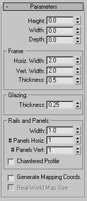

Parameters rollout
The topic for each kind of window describes its unique controls and behavior. Some window parameters are common to all kinds of windows; see Windows.
Rails and Panels group
Width
Sets the width (depth) of the rails in the sashes.
# Panels Horiz
Sets the number of horizontal divisions in the window.
# Panels Vert
Sets the number of vertical divisions in the window.
Chamfered Profile
Chamfers the rails between the glazed panels, as in a conventional wooden window. When Chamfered Profile is off, the rails have a rectangular profile.
