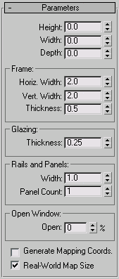

Parameters rollout
Height/Width/Depth
Specifies the overall dimensions of the window.
Frame group
Horiz. Width
Sets the width of the horizontal part of the window frame (at the top and bottom). This setting also affects the glazed portion of the window's width.
Vert. Width
Sets the width of the vertical part of the window frame (at the sides). This setting also affects the glazed portion of the window's height.
Thickness
Sets the thickness of the frame. This also controls the thickness of casements or railings on the window's sashes.
Glazing group
Thickness
Specifies the thickness of the glass.
Generate Mapping Coordinates
Creates the object with the appropriate mapping coordinates already applied.
Real-World Map Size
Controls the scaling method used for texture mapped materials that are applied to the object. The scaling values are controlled by the Use Real-World Scale settings found in the applied material's Coordinates rollout. Default=off.
