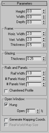

Parameters rollout
The topic for each kind of Window describes its unique controls and behavior. Most Window parameters are common to all kinds of Windows; see Windows.
Rails and Panels group
Rail Width
Sets the width of the rails in the sash.
# Panels Horiz
Sets the number of horizontal divisions in each sash.
# Panels Vert
Sets the number of vertical divisions in each sash.
Chamfered Profile
Chamfers the rails between the glazed panels, as in a conventional wooden window. When Chamfered Profile is off, the rails have a rectangular profile.
Open Window group
Hung
When on, the window slides vertically. When off, the window slides horizontally.
Open
Specifies the percent that the window is open. This control is animatable.
