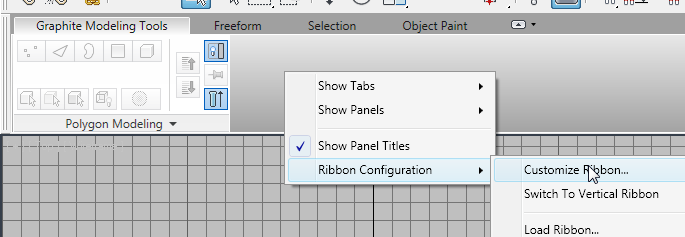

  3. Right-click an empty area of the ribbon and choose Ribbon Configuration > Customize Ribbon.
    The Customize Ribbon dialog opens.

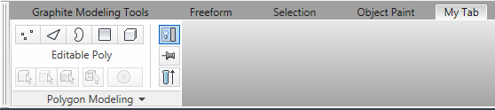

  8. In the field that contains the text “New Tab,” double-click the word “New” so it highlights, and then on the keyboard, type My followed by a space, and then press Tab.
    The new ribbon tab is now named “My Tab.”
  9. Press and hold the Shift key, and then drag the Polygon Modeling item in the Existing UI list (under Graphite Modeling Tools) to just below the My Tab item. Before you release the mouse button, make sure a + icon appears on the cursor, as shown in the following illustration.
    A copy of the Polygon Modeling panel item appears as a child of My Tab item. You can confirm the copy by clicking the My Tab tab on the ribbon. You’ve just populated your tab!

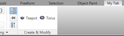

  4. Scroll down to the Teapot entry, and then drag it to the Create & Modify panel entry in the Existing UI list.
    The Teapot command appears in the list and on the new panel in the ribbon. The name “Teapot” appears in the list, but not on the ribbon. However, the default icon appears in both places. You can change the image, if you like, with the Icon property; this procedure doesn’t cover the details.
  5. Turn on the Show Text property for the Teapot item.
    Now the name “Teapot” appears next to the icon. The ribbon button has widened to fit both the icon and the label.
  6. Also add the Torus command and turn on its Show Text property.
    The two buttons sit side by side on the panel, which widens to fit. But what if you want them to be arrayed vertically?

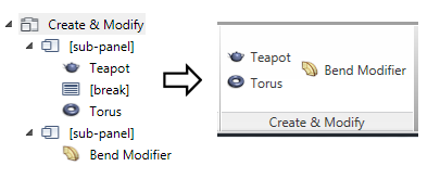

  11. From the Ribbon Controls list, drag a Sub-Panel control to anywhere on the Create & Modify section of the Existing UI list, and then add a second sub-panel.
    If the second sub-panel appears as a child of the first (that is, indented), just drag it to the left to move it to the same hierarchy level as the other panel items.
  12. Drag the Teapot and Torus items to the first sub-panel, and then drag either Break item between them. Drag the Bend Modifier item to the second sub-panel, and delete the second Break.
    Now the objects appear on the left side of the panel, while the modifier is on the right.

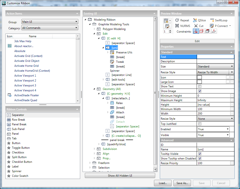

The Customize Ribbon dialog window functions like most other dialogs. To resize it, drag an edge or corner, and to reposition, drag the title bar. To collapse or expand a section, click the triangle at the right end of its header. To change the proportions between sections, drag the vertical or horizontal divider. Although the right-hand column contains sections, the Preview Window is a fixed size, so the only way to give the Properties section more vertical room is to collapse The Preview Window.
The dialog user interface comprises five main areas plus several buttons. This section describes the areas and, where necessary, provides links to sections with further explanation.
Action Items
This section lists all the 3ds Max functions you can assign as ribbon controls, and provides most of the same features as the equivalent on the Customize User Interface dialog.
To add a command to the ribbon, first choose its group and category from the Group and Category lists, then find it in the Action list and drag it to the appropriate location in the Existing UI hierarchy in the center of the Customize Ribbon dialog.
When you add a command to the ribbon in this way, it creates a button. The behavior of the button depends on the nature of the command as defined in the software. For example, the button for a geometric primitive such as Box remains on when clicked, so that you can create several boxes in succession. On the other hand, a button for a modifier activates only momentarily, applying the modifier to the selected object.
Ribbon Controls
Lists all user-interface elements (independent of specific commands) you can add to the ribbon. For descriptions of these, see Ribbon Controls.
Existing UI
A tree view, or hierarchical list, of the ribbon user interface. To expand or collapse a tree branch, click the arrow next to the parent item. The arrow for a collapsed branch appears as a gray outline pointing to the right; for an expanded branch, the arrow is black and points to the bottom-right.
If you right-click a collapsible element in the list, such as a panel or sub-panel, a menu opens giving you the option to Collapse All or Expand All: This refers to the element and its children.
Also, if you right-click a tab element, an additional Export menu item lets you save the tab as a XAML file. The default output folder for this file is UI\Ribbon\Extensions in the program install directory. If you give this file to another user who copies it into the same folder on their PC, it is automatically installed into the ribbon on their version of 3ds Max without interfering with the rest of their ribbon.
By default, the list contains only features active in the ribbon. For example, if no object is selected, the Graphite Modeling Tools branch contains only the Polygon Modeling panel, but if an editable poly object is selected, a number of additional panels appear in that branch.
Alternatively, to display all ribbon contents regardless of the current program status, turn on the Show All Hidden UI toggle below the Existing UI list. Typically you’ll want to keep that off, though.
If an item’s name is green, its Available or Visible propertyhas been set to Conditional. For details, see Conditions dialog.
Preview Window
Shows the panel of the highlighted item in the Existing UI list, including the panel name. When a tab is highlighted in the list, no preview is available.
The preview window is interactive to a limited extent: Clicking an item highlights it in the Existing UI list and shows its properties in the Properties section. Similarly, clicking an item in the Existing UI list highlights its visual representation in the preview window. Also, hovering the mouse above a preview item shows the tooltip, if available. However, the preview window does not support changing settings or opening drop-down lists.
Properties
Shows all available settings for the highlighted item in the Existing UI list.
The Properties settings are self-documented with tooltips on the Customize Ribbon dialog, so they aren’t described in detail here. A few general notes, however:
Tip: To learn how a particular property works, examine the property in existing controls of the same type. Try changing the setting (such as the spinner Maximum value) and observe how this affects the control’s behavior. As long as you don’t save, you’ll have a chance to revert all changes when you close the dialog.

image Sub-Panel
A sub-panel is a self-contained subgroup of controls within a panel or parent sub-panel. It works much the same as a panel (see following), except that by placing multiple sub-panels on a panel, you can create a neater arrangement of the panel contents.
A sub-panel acts like a column on a multi-column page of text, or in a spreadsheet. All the items on the sub-panel line up on their left edges, assuming you place a Row Break control between each pair of items.
You can find numerous examples of this usage on the default horizontal ribbon included with 3ds Max, as well as examples of nested sub-panels. For example, on the Freeform tab (make sure you have an editable poly object selected), the PolyDraw panel includes two sub-panels. If you expand the first one, [C: polydraw H], you can see two [poly draw tools] sub-panels at the end, separated by a Spacer separator. And if expand these, you can see how the two columns of controls on the right side of the PolyDraw panel, headed respectively by Shapes and Topology, are arranged.
You can nest sub-panels only once; in other words, you can put a sub-panel inside a sub-panel, but you cannot nest them any deeper than that.

Buttons
The Customize Ribbon dialog buttons provide controls for saving and loading ribbon configurations, plus toggling the display of all UI items.
Show All Hidden UI
By default, the Existing UI list shows only interface elements currently visible in the ribbon, based on conditions. For example, sub-panels with the Horizontal condition are usually hidden in the vertical ribbon. To make all ribbon elements available for editing, regardless of conditions, turn on Show All Hidden UI.
Tip: When Show All Hidden UI is on, it can be difficult to find a specific item for editing. To make it easier to find a particular interface element, place 3ds Max in a state that makes the desired ribbon elements visible, and edit with Show All Hidden UI off.
Load
Opens a file dialog for loading a ribbon scheme file, which uses the filename extension .ribbon. Typically you would use this to load a custom ribbon that you saved previously with Save As (see following).
Save As
Opens a file dialog for saving the customized ribbon in a ribbon-configuration file, which uses the filename extension .ribbon. Use Load subsequently to restore this configuration.
Save and Save As work somewhat differently in Customize Ribbon than the way you might be accustomed to in other contexts. For an explanation, see Save, following.
Save
Saves any changes to the ribbon to the default startup ribbon configuration, which is typically not the same file saved with Save As. Available only when the ribbon has changed since the previous save or opening the dialog.
To further explain the difference between Save and Save As, say you customize the ribbon, then save it to a file such as MyRibbon.ribbon with Save As. Then you make some more changes and use the Save command. This does not overwrite the MyRibbon.ribbon file; it overwrites the default ribbon startup file. To save further changes to a non-default file, always use Save As.
Tip: As noted, the Save command replaces the startup ribbon configuration with the customized ribbon. To return to the factory-default ribbon, right-click the ribbon and choose Ribbon Configuration > Reset Ribbon To Default.
Cancel
Discards any changes made to the ribbon since opening the dialog or saving the ribbon. Available only when such changes exist.
image [close button]
The close button is found in the top-right corner of the Customize Ribbon dialog, and, when clicked, closes the dialog. If you’ve made any unsaved changes, you’re prompted whether to save the changes.
If you click Yes, the changes are saved to the default ribbon-configuration file and the dialog closes. If you click No, any changes subsequent to the last save (or opening the dialog, if you haven’t saved) are discarded.
