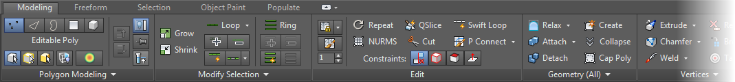

Graphite Modeling Tools
The Graphite Modeling Tools set is found on the ribbon. These tools give you a wide variety of features for editing polygon objects.
The ribbon contains all standard Edit/Editable Poly tools as well as additional tools for creating, selecting, and editing geometry. Also, you can customize the ribbon however you like. For details, see the following links.
Tip:
If the ribbon does not appear in the program interface, choose Customize menu > Show UI > Show Ribbon or, on the Main Toolbar, click image (Toggle Ribbon).
