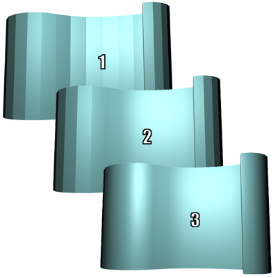

1. No smoothing applied
2. Smoothing threshold=15
3. Smoothing threshold=30
