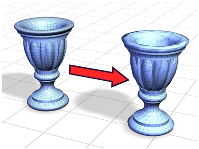

The Optimize modifier lets you reduce the number of faces and vertices in an object. This simplifies the geometry and speeds up rendering while maintaining an acceptable image. A Before/After readout gives you exact feedback on the reduction as you make each change.
Optimize simplifies a smooth model with a high number of faces without greatly changing the model’s appearance.

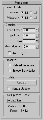

Interface
Level of Detail group
Renderer L1, L2
Set the level of display for the default scanline renderer. Use Viewports L1 and L2 to change the stored optimization level. Default=L1.
Viewports L1, L2
Set the optimization level for both viewport and renderer. Also toggles the level of display for the viewport. Default=L1.
Optimize group
Adjusts the degree of optimization.
Face Thresh
Sets the threshold angle used to determine which faces are collapsed. Low values produce less optimization but better approximations of the original shape. Higher values improve optimization, but are more likely to result in faces that render poorly (see Bias). Default=4.0.
Edge Thresh
Sets a different threshold angle for open edges (those that bound only one face). A low value preserves open edges. At the same time you can apply a high face threshold to get good optimization. Default=1.0.
Bias
Helps eliminate the skinny or degenerate triangles that occur during optimization, which can cause rendering artifacts. Higher values keeps triangles from becoming degenerate. The default of 0.1 is enough to eliminate the skinniest triangles. Range=0.0 to 1.0 (a 0 value turns Bias off).
Max Edge Len[gth]
Specifies the maximum length, beyond which an edge cannot be stretched when optimized. When Max Edge Len is 0, it has no effect. Any value greater than 0 specifies the maximum length of the edges. Default=0.0.
Along with Bias, this control helps you avoid creating long skinny faces while optimizing.
Auto Edge
Turns edges on and off following optimization. Turns on any open edges. Turns off any edges between faces whose normals are within the face threshold; such edges beyond the threshold are not turned on. Default=off.
Preserve group
Maintains clean separation at the face level between material and smoothness boundaries.
Material Boundaries
Prevents face collapse across material boundaries. Default=off.
Smooth Boundaries
Optimizes an object and maintain its smoothing. When turned on, allows only faces that share at least one smoothing group to collapse. Default=off.
Update group
Update
Updates the viewports with the current optimization settings. Available only when Manual Update is turned on.
Manual Update
Enables the Update button. When turned off, Optimize works as it does by default, updating the viewport display dynamically.
Note: When using Manual Update, if you make any changes that cause the reevaluation of the stack, the existing optimization display disappears. Click the Update button again to restore it.
The Renderer ignores the optimization display in the viewport, using the Optimize settings, regardless of the state of the Manual Update.
Last Optimize Status group
Displays numerical results of optimization with exact before-and-after counts for vertices and faces.
