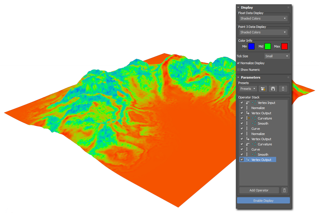

An example of the Data Channel modifier being used to isolate specific topographical features using curvature data. This process stack could be used to mask off areas for convincing snow accumulations, for instance, that would update automatically after any further modelling.
