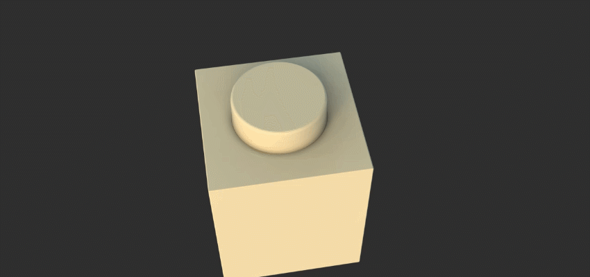

The new parametric Array modifier lets you create arrays using multiple Distribution methods. Its expansive toolset includes transformation and randomization controls, and parameters to adjust material IDs and UV data.
Modify panel > Make a selection > Modifier List > Object-Space Modifiers > Array
The parametric Array modifier lets you create arrays using multiple Distribution methods. Its expansive toolset includes transformation and randomization controls, and parameters to adjust material IDs and UV data.
With an expansive toolset and a location in the stack, the Array modifier provides additional flexibility not found in the Array command. Most importantly, this modifier is parametric, giving you the ability to adjust parameters after an array has been created.

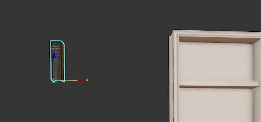

The Array modifier is especially useful in a procedural modeling context. For example, you can create an array to quickly model detail or ornamentation:
Stiches on a surface
Bolts on an airplane wing
Bricks for a wall
Books on a bookshelf
When applied to a mesh or spline, the Array modifier creates clones based on the selected Distribution method. You can choose to duplicate and distribute clones using the following methods:
