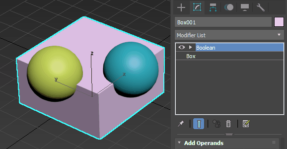

The Boolean Modifier combines objects into a single mesh by performing a boolean operation(s). You can use this modifier to accomplish tasks that are difficult to complete with traditional modeling methods.
Unlike the ProBoolean and Boolean compound objects, the Boolean modifier is located in the Modifier stack, allowing you to model procedurally. This flexibility makes the Boolean modifier the recommended method for performing boolean operations in 3ds Max.
The Add Operands rollout lets you use different operations to combine operands to make shapes that would otherwise be difficult to model using other techniques:
You can use the Operands rollout to edit your operands at any time, previewing changes in your scene in real time. Turn on Manipulate Operands to quickly select operands directly in the viewport instead of using the rollout.

When using the Boolean modifier, edge seams at the intersection of boolean operations are passed up the stack to be used with other modifiers. In the following example, two spheres have been subtracted from a box. An Edit Poly modifier is applied to the Box. When the Edge sub-object level is enabled, all the boolean edge seams are selected.
