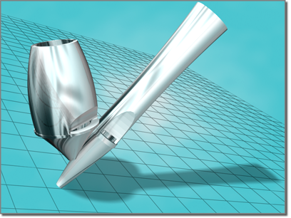

Applying a Stretch modifier to the object on the left creates the object on the right.
