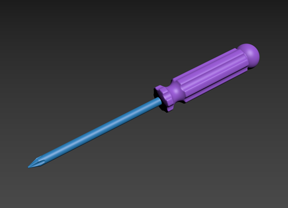

Create a screwdriver using the Boolean Modifier
The following workflow describes how to create a screwdriver handle using the Boolean modifier. It highlights how you can use the OpenVDB method to create watertight geometry. It also illustrates how to use the Array modifier in conjunction with the Boolean modifier.

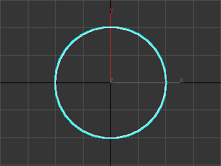

  1. Create a cylinder in the front view (Cylinder001).
  2. In the Modify panel, set the following parameters:
    • Radius: 20.0
    • Height: 15.0
    • Sides: 30
  3. Select the Move Tool.
  4. Select the Transform Type-in ( Edit > Transform Type-in) and set the Absolute: World X, Y, and Z values to 0.0
    This positions the cylinder at the origin.

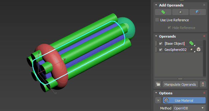

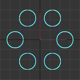

  9. Select Cylinder002.
  10. In the Modify panel, select Array from the Modifier List.
  11. In the Distribution rollout, set the following:
    • Distribution method: Radial
    • Count: 6
    • Radius: 25.0
    Now six cylinders partially intersect the first cylinder that was created (Cylinder001).

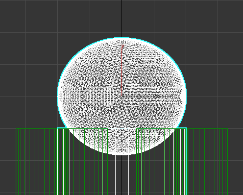

  12. Create a GeoSphere in the top view (GeoSphere001).
  13. In the Modify panel, set the following parameters:
    • Radius: 20.0
    • Segments: 20
  14. Scale the geosphere in the Y-axis until it is an oblong shape.
  15. Position the geosphere so it overlaps the top of Cylinder001.

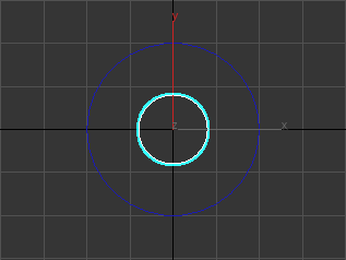

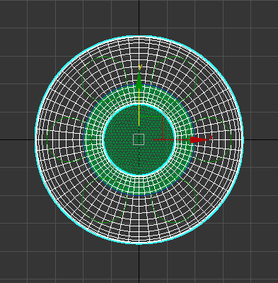

  16. Create a torus in the front view (Torus001).
  17. In the Modify panel, set the following parameters:
    • Radius 1: 25.0
    • Radius 2: 12
    • Segments: 60
    • Sides: 30
  18. Position the torus so it is centered with Cylinder001.
  19. With the torus still selected, select the Move Tool.
  20. Select the Transform Type-in ( Edit > Transform Type-in) and set the Absolute: World Y to 22.0.

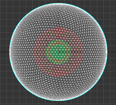

  21. Create another geosphere (GeoSphere002).
  22. In the Modify panel, set the following parameters:
    • Radius: 75.0
    • Segments: 20
  23. Ensure GeoSphere002 is centered to Cylinder001.

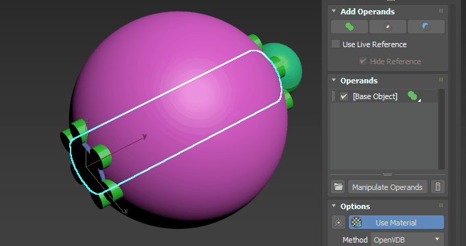

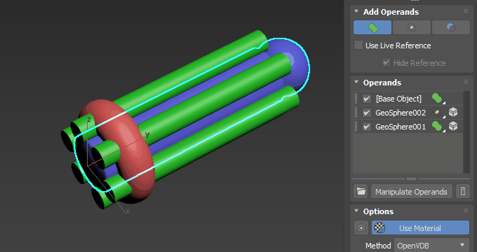

Add a Boolean Modifier to create the handle
  1. Select Cylinder001.
  2. In the Modify panel, select Boolean from the Modifier List.
  3. In the Options rollout, set the method to OpenVDB.
    The handle geometry is now converted to a VDB based mesh.
  4. In the Add Operands rollout click the Intersect icon image.
  5. Select GeoSphere002.
    This step rounds the ends of Cylinder001.
  6. In the Add Operands rollout click the Union icon image.

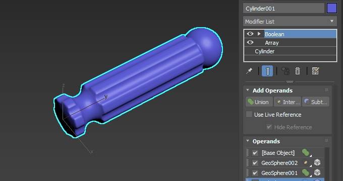

  7. Select GeoSphere001.
    This merges the rounded end of the handle to the rest of the model.

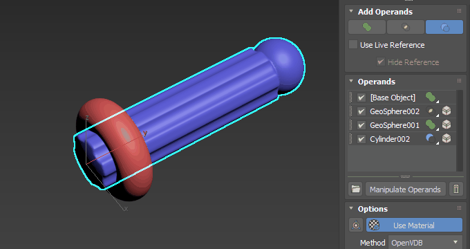

  8. In the Add Operands rollout click the Subtract icon image
  9. Select Cylinder002, the array of six cylinders.
    This step cuts away parts of the handle, creating indentations for the grip.
  10. With the Subtract icon still enabled, select Torus001.
    This final step creates an indentation at the base of the handle.
