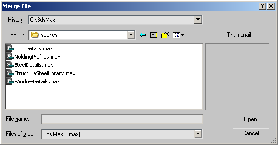

Merge File Dialog (Sweep Modifier)
The Merge File dialog for the Sweep modifier appears when you click the Merge From File button. Merge From File allows you to bring shapes or section profiles from other scene files into the current scene.

In the standard file selector dialog, select the scene file to merge. You can only merge MAX files.
This dialog has the same functionality as the Merge File dialog that appears when you choose File menu > Import > Merge with one minor exception.
If you choose a MAX file that does not include a valid 2D shape that can be used as a custom section, you will receive a warning.

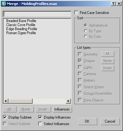

Once the scene file is selected, you can choose the shape or section profile that you want the Sweep modifier to use.
If the scene file you selected contains multiple shapes, keep in mind that you can only choose one shape to be swept along the spline in your current scene.
All/None/Invert
These buttons are unavailable when Merge From File is used in the Sweep modifier.
Display Subtree
Displays the shapes in the list in an indented format. Turn off this option to activate the Sort group options.
Select Subtree
This switch is unavailable when Merge From File is used in the Sweep modifier.
Find Case Sensitive
Distinguishes between uppercase and lowercase for item names.
Sort group
These options are unavailable when you are picking shapes for the Sweep modifier.
List Types group
