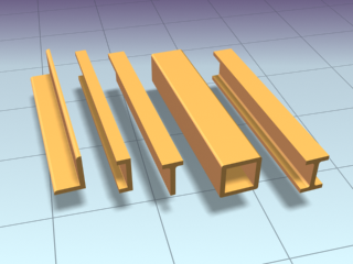

Examples of extrusions created with the Sweep modifier
