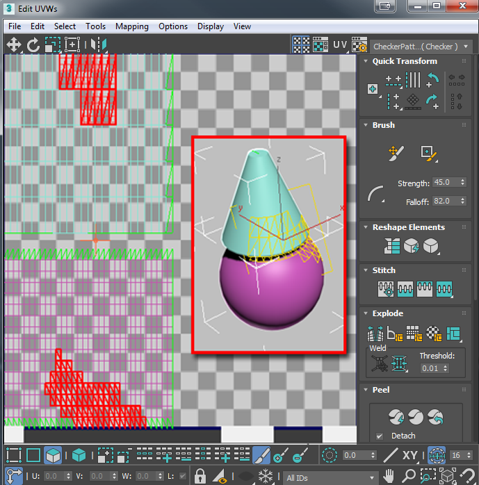

Support for Multiple Unwrap Objects
Instancing capabilities in Unwrap UVW make it easy to apply texture coordinates across several objects. First select the objects, then apply Unwrap UVW. When you open the editor, you’ll see the mapping coordinates for all selected objects containing the instanced modifier. The editor shows each object’s wireframe color to help you see which set of coordinates belong to each object.
Left: Two objects’ UVW coordinates in the editor, showing wireframe colors
Right (inset): The objects with a shared Unwrap UVW modifier in the viewport
Tip: The UVWs of different objects typically start out overlapped in the editor, so it’s a good idea to separate them before editing. To save time, use one of the Pack tools.

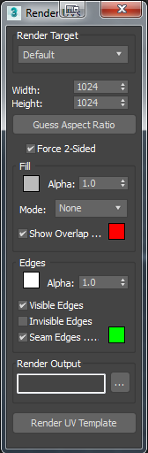

  2. From the Edit UVWs dialog menu bar, choose Tools > Render UVW Template.
    Note: If your driver does not support the graphic mode, you cannot select Render UVW Template.
    This opens the Render UVs dialog:
  3. Select the render target.
  4. Set the Width and Height values to the output resolution you want in the rendered template. You'll usually get good results by setting the desired width and then clicking Guess Aspect Ratio.
    Tip: When creating texture maps for gaming and other real-time 3D engines, be sure to set both dimensions to powers of 2: 256, 512, 1024, and so on.
  5. Change the remaining values as needed. By default, the template is rendered with the edges as white and opaque (alpha=1.0), and background is empty and transparent (background alpha=0.0), but you have a variety of choices here, as detailed in Render UVs Dialog.
  6. At the bottom of the dialog, click Render UV Template.
    This opens a new rendered frame window containing the rendered template as a bitmap. Inspect the output, and if changes are necessary, make them on the Render UVs dialog and re-render.
  7. When you're satisfied with the results, then on the rendered frame window toolbar, click Save Bitmap, and then use the file dialog to specify the file type and name. Click Save to export the file.
    If you want to use the rendered transparency information in the paint program, be sure to save in a format that supports the alpha channel, such as TIF or Targa.
  8. Open the exported image in a paint program and use the rendered edges as a guide for painting the texture map. Save the image when done.
    Be sure to paint over or erase all the edges so they don't appear in the final texture.

image Quick Planar Map
Applies planar mapping to the current texture-polygon selection based on the orientation of the Quick Map gizmo.
Using this tool "breaks" the selected texture polygons off as a separate cluster, which is then scaled to fit the editor extents, using the alignment specified on this rollout.
image Display Quick Planar Map
When on, a rectangular planar mapping gizmo, applicable to the Quick Planar Map tool only, appears juxtaposed over the polygon selection in the viewports. You cannot adjust this gizmo by hand, but you can use the following control to reorient it.
image X/Y/Z/ Averaged Normals
Choose the alignment for the quick planar map gizmo from the flyout: perpendicular to the object's local X, Y, or Z axis, or based on the polygons' average normals.
Note: Although the X icon shows by default, the actual default choice for this setting is Averaged Normals.

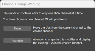

Each object can have up to 99 different UVW mapping coordinate channels. The default mapping channel (from the Generate Mapping Coordinates toggle in the object’s creation parameters) is always channel 1. You can specify texture coordinates for any channel by using a different Unwrap UVW or UVW Map modifier for each channel.
Map Channel
Sets the identification number of the texture coordinates controlled by this modifier. This channel value corresponds to the Map Channel value set in a map’s parameters, so that the modifier controls how maps set to the same channel are applied to the object surface. Default=1. Range=1 to 99
Please note the following important points about map channels in the Unwrap UVW modifier:
The map channel setting is available in various places in 3ds Max, as follows:
Vertex Color Channel
Define the mapping channel as a vertex color channel by choosing this option. Be sure to match any material mapping in the coordinates rollout to be Vertex Color as well, or by using the Assign Vertex Colors utility.
