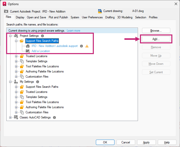

  2. With the drawing file open, right-click the drawing area and choose Options.
  3. In the Options dialog box, Files tab, expand the Project Settings node.
    If the Project Settings node is not visible, then the Connected Support Files feature might not have been set up for the project. To set up Connected Support Files, see To Set Up an Autodesk Project to Use Connected Support Files.
  4. Under Project Settings, expand the setting nodes to view their currently assigned paths.
  5. With a setting node expanded, do one of the following:
    • Select a node and click Add to add a new path to the setting.
    • Double-click a path under a setting to modify its location.

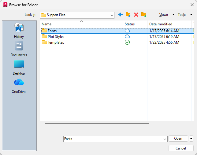

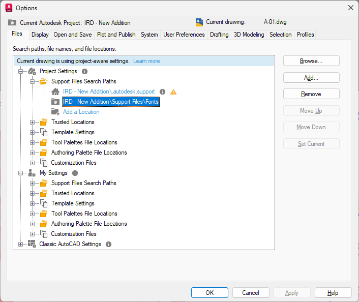

  6. Browse to a folder or file location within the Autodesk project and click Open.
  7. Continue adding and modifying paths for each of the settings as needed.
  8. Click Apply to save the path settings to the project.
