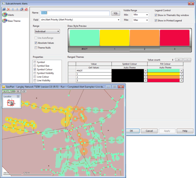

To see alerts as a theme on the GeoPlan, drag and drop the alert instance list object onto the simulation opened in the GeoPlan.
When an Alert Instance List is generated, at least two new results fields to the corresponding simulation:
For each network object, the value of these new fields is determined by the presence of any alert instances associated with that object. In other words, Sim.Alert Count is the number of alerts associated with that object (at a given time) and Sim.Alert Priority is the priority of the highest priority alert associated with that object (at a given time).

Objects are themed in descending priority of sub-theme, so users would typically assign the Alert theme at the top to override any underlying more standard theme definitions. Please refer to the Theme Precedence topic note for more information.
Note: Only alert instances corresponding to alert definitions that have their Visibility field set to either Grid + Theme or Theme Only can be themed on the GeoPlan. See Alert Definition Lists for further information .
Example of GeoPlan alert theme on a selection of subcatchments
Example of GeoPlan alert theme on a selection of subcatchments for which the rainfall exceeds a given threshold, and corresponding theme attributes

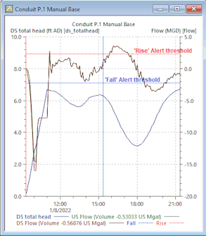

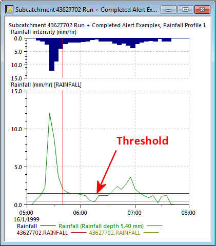

When a results graph is displayed for an object and results field combination that contains an alert, most data relevant to that alert definition is displayed on the graph. In particular, the constant threshold when Target type B is <FIXED VALUE>, or the result of Target B when Target B is pointing at another network object.
Results graph
When an alert is defined that includes a Comparison operator and Target type B set to <FIXED VALUE>, you can choose a Graph trace colour that will be used for the threshold colour in the graph.
Results graph with alert threshold
Results graph for a conduit showing Flow, and US and DS total heads attributes, and thresholds for 'Fall' and 'Rise' Alert definitions
