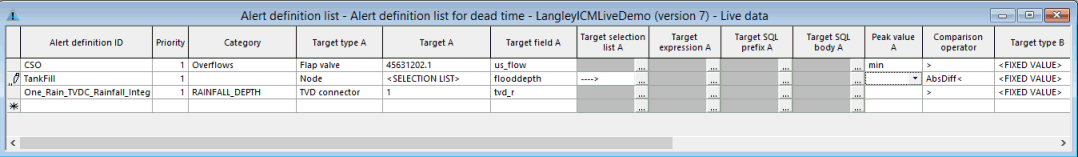

The alert definition list consists of a grid containing alert definitions.
Alert Definition List grid
