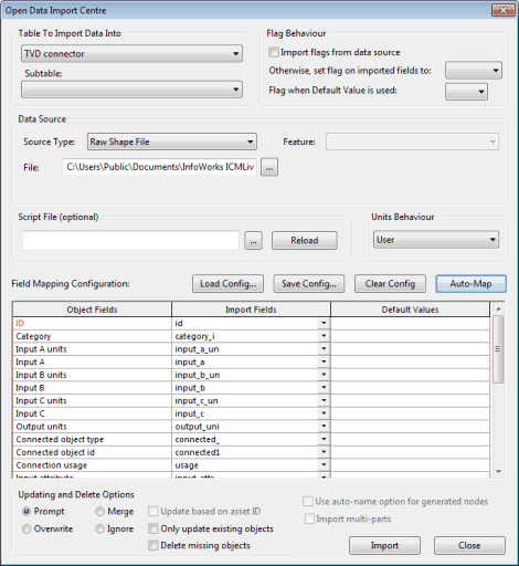

  1. Select the Import | Open Data Import Centre option from the Network menu.
  2. The Open Data Import Centre dialog is displayed.
    1. Set the Table to Import Data Into dropdown list to TVD connector.
    2. Select the Source Type to Raw Shape File.
    3. Browse for the rain_gauges.shp file stored in the rain_gauge_polygons folder of the example data using the Browse button button adjacent to the File box.
    4. Click the Auto-Map button to map the fields.
    ODIC Dialog
  3. Click Import. A confirmation message is displayed letting the user know how many objects have been imported or updated. Click OK to close it.
  4. Click Close to close the dialog once the import is complete.

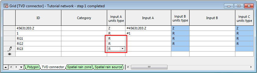

  5. Open the polygons grid to investigate the newly imported TVD Connector properties. For this, you can select the New polygons window using the Grid Combo button button of the Windows toolbar. Scroll to the TVD connector tab.
  6. For each of the three new entries, set the input units to R for rainfall intensity (mm/hr). We want to associate a live feed of data to each of these rain gauge polygons and this needs to be set up in the Scalar TSDB object.

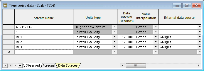

  8. On the Observed tab:
    1. Specify three new stream names RG1, RG2 and RG3.
    2. Set the units (Units) to Rainfall intensity and the Data interval to 120 sec.
    3. Use the dropdown of the External data sources field to select the external data source name Gauges and set the external units (External units) to mm/hr.
    4. Set Min. Threshold to 0mm/hr and Max. Threshold to 100mm/hr.
      Configuring Data Sources

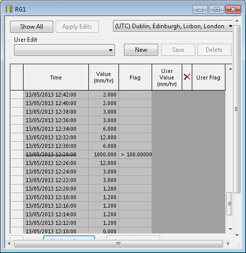

    5. Right click on each row in turn and select Test connection. If the response is OK then right click and select Show time series data for the RG1 data stream. The Time Series Data Grid opens.
    6. Click the Update data button. In the Update Time Series Data dialog that gets displayed, enable Update data in the specified time range and set the Lower limit to 00:00:00 on 13/05/2013.
      Update Time Series Data Dialog
    7. Click OK in this dialog, then OK in the Schedule Job(s) dialog. Note that there has been a correction to the data in RG1, at time 12:28 on 13/05/2013 as the value read in was greater than 100mm/hr.

  9. To allow cross referencing of the data streams make sure that the Scalar TSDB object is open in the GeoPlan. This can be seen in the GeoPlan titlebar, where the name of the TSD object has been appended to the name of the network. Open the polygons grid and scroll to the TVD connectors tab:
    1. Delete the two TVD connectors (1 and 45631203.Z) that were automatically created when telemetry was first imported into the Scalar TSDB object. For this, right-click each row in turn and select Delete Row.
    2. For the remaining TVD connectors, associate the appropriate data stream with the Input A. If the data in Input A runs out, then the data stream associated with Input B will be used (if available) and so on. We will only use the Input A field in this tutorial.
    3. Specify a category of gauge for each of the TVD connectors.
