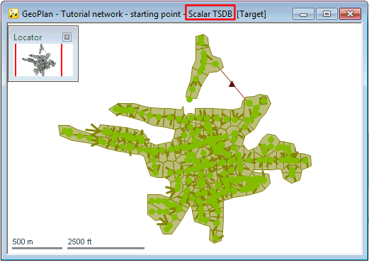

  6. Open the Tutorial network - starting point network on the GeoPlan window. Drag the Scalar TSD object on top of the network GeoPlan. You should see that the name of the Scalar TSDB appears in the GeoPlan title bar:
    GeoPlan titlebar

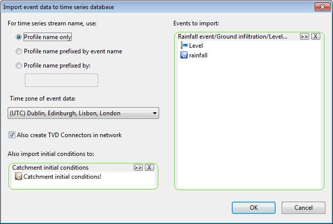

  7. Using the Network menu, select the Import | Event data into time series database option.
    1. In the Import event data to time series data dialog that appears, ensure that the Also create TVD connectors in network option is checked.
    2. This will make sure that connections are automatically created between the TSD data streams and the objects in the network. TVD connectors (time varying data connectors) are network objects which are associated with both a network object and a data stream. They can contain polygon information if they are to be associated with a rain gauge, and will also allow the user to specify a fall back strategy, such as if data stream A does not contain any data (if a gauge has stopped transmitting) then fall back to using data stream B etc. Other data streams can be added to the model later, but the user will need to manually create TVD connectors in the network to ensure the data is fed to the correct location.
    3. Drag and drop the provided level (Level) and rainfall (Rainfall) tree objects into the Events to import section.
    4. Also drag and drop the newly created Catchment initial conditions object (Catchment initial conditions) in the droptarget of the same name.
      Import event data to time series database dialog

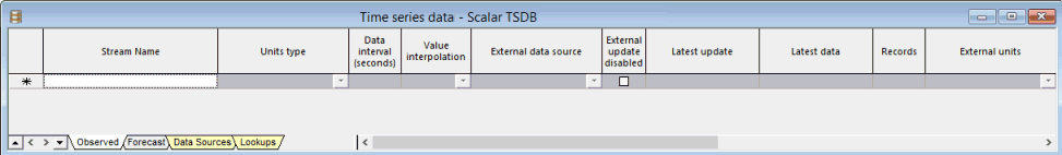

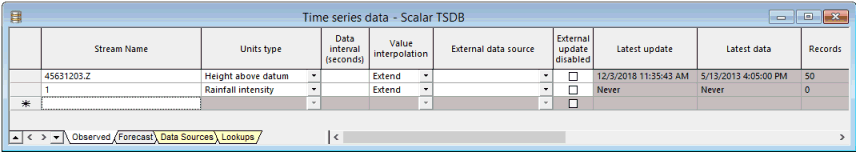

  9. Open the Scalar TSDB object, by dragging it onto the main window background or right-clicking on it and selecting Open. Note that there are now two entries in the observed tab. Select one of these entries in the Observed tab, right-click and select Show time series data from the pop-up menu. The time varying data that has been imported is displayed. Close this dialog by clicking the button located in the top right-hand corner of the window. The other tabs in the Scalar TSD grid are empty, but some of them will be populated later in this tutorial.

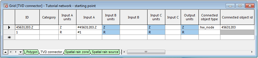

  12. With the network open in the GeoPlan view, open the polygon grid by selecting New polygons window from the Grid Combo button button of the Windows toolbar. Scroll to the TVD connector tab. Note that there are two new entries. The TVD connectors relate to the rainfall profile and the outfall level time series used in the original model simulation. Note that a TVD Connector object exists as an object in the network for the outfall (45631203.Z) but not for the rainfall profile (1). Investigate the properties of the TVD connector. In the input fields, # denotes that the data is an external data source. If an input is not preceded by # then it must be referencing another TVD connector within the network.
